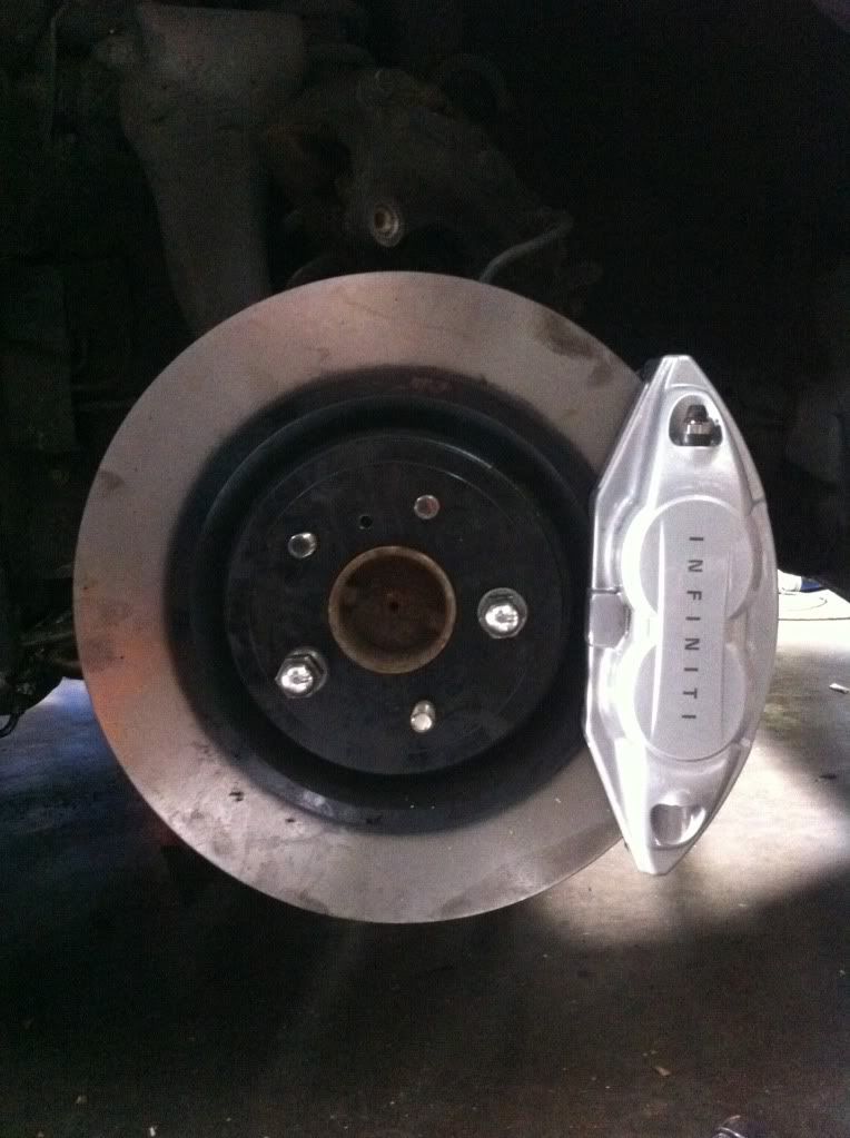

Message As some of you may remember that last year I bought a set. I had a shop lined up to make the brackets but since he was having " personal " problems he told me 4 months after having the brakes that he would not be able to make them. A few months go by while I look for another shop to make them. After locating such shop I gave them half of the brakes ( rotors/pads/calipers ). After having them draw them up, sent the file to the machine and 1 month later. I have test product in my hand, and got a chance to test fit the front.

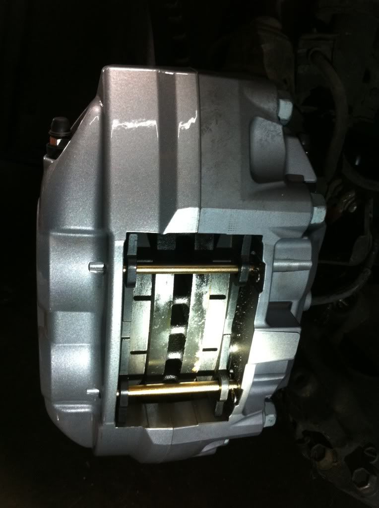

There is ZERO pad over hang. Pad is a tad below edge of rotor.
The bracket is made from T6061.
